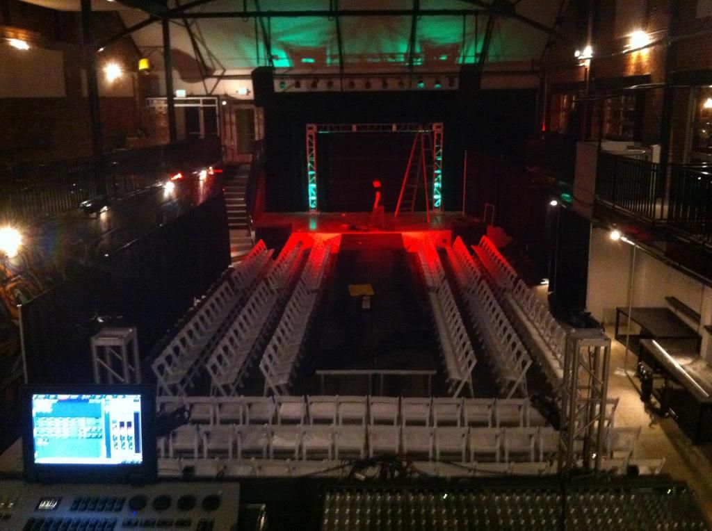

Sampson
  • Guest
Re: What lens should I use at my first Fashion Show?
« Reply #8 on: October 10, 2012, 12:22:39 PM »
https://vimeo.com/50657165
This will be the catwalk.
