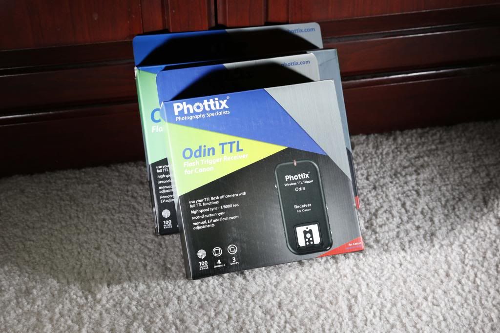

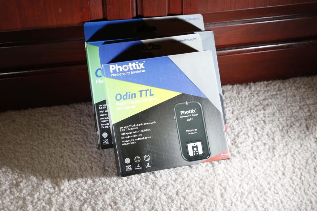

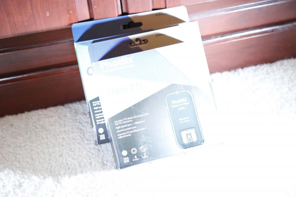

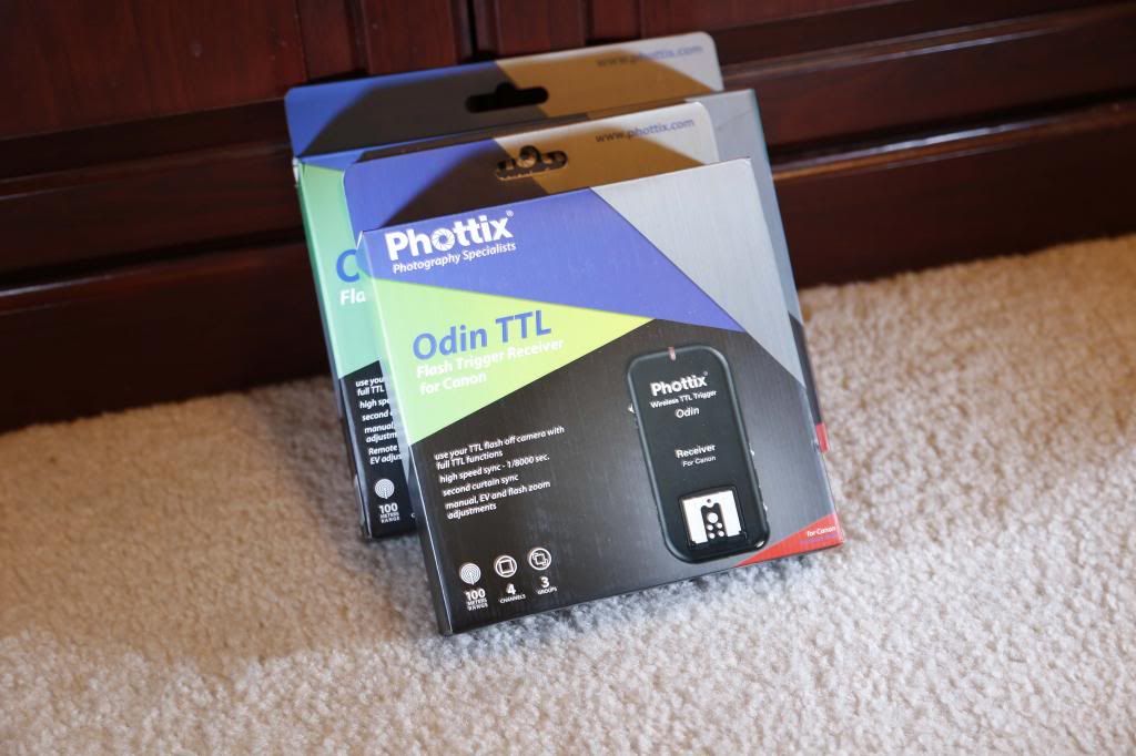

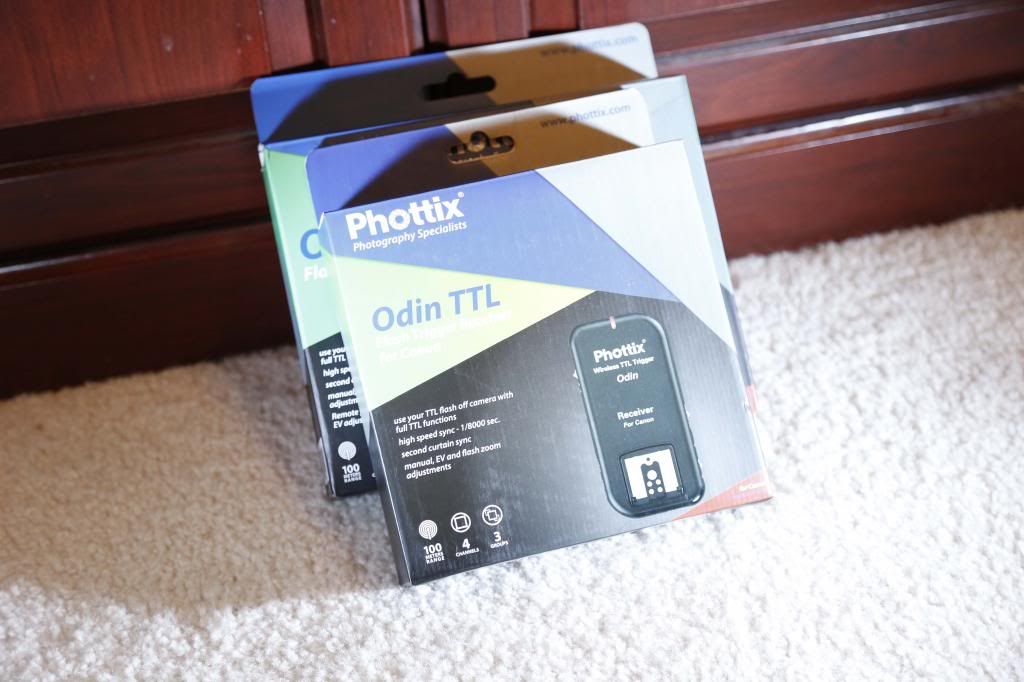

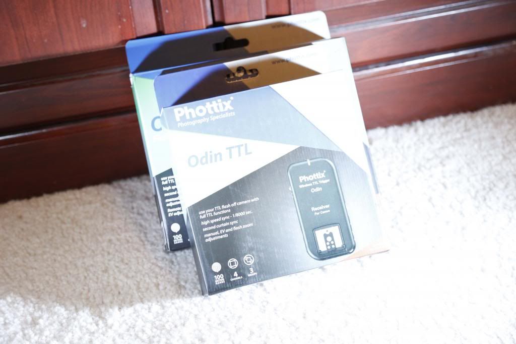

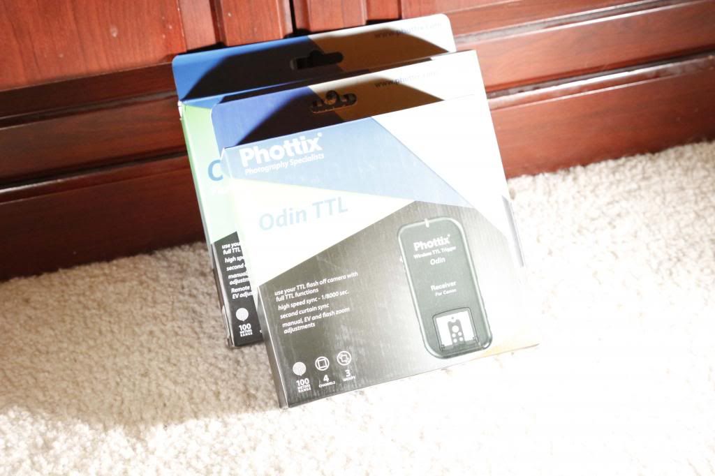

I've been proudly pimpin' my ancient 550EXs for quite some time now, and decided to step up from infrared to a set of Phottix Odins. With my 5D3 in Av mode, I've noticed that the flash exposure is pretty accurate and consistent up to ISO 400, but drop off a table after that. From ISO 800 and up, it seems like the Odin's don't "meter down" the flash exposure enough, and the result is way too much light output. Either that, or the Odins don't recognize that the ISO has been increased.
Here are some sample shots with the flashes set to the left and right of the subject. To keep the ambient light levels consistent, the aperture was kept at f/4, but the shutter speed varied from 1 second to 1/125 second.
ISO 100
ISO 200
ISO 400
ISO 800
ISO 1600
ISO 3200
ISO 6400
ISO 12,800

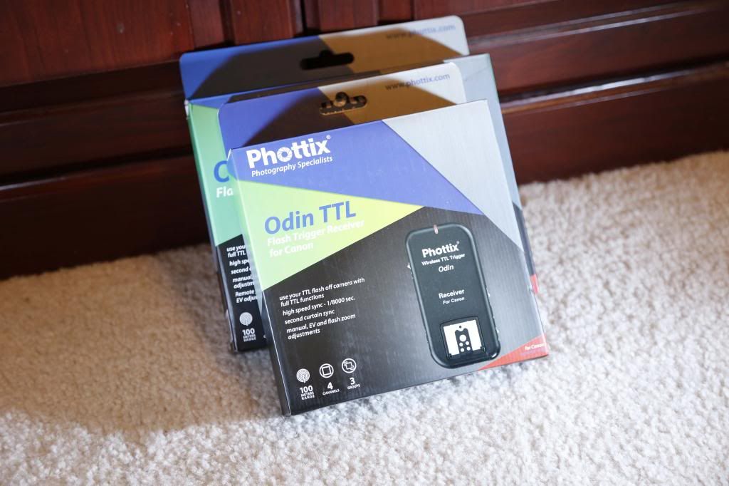

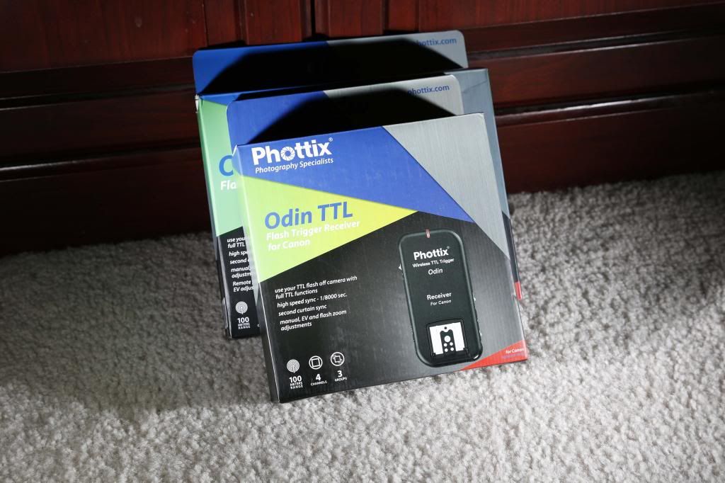

Interestingly, the ETTL flash metering is much more accurate with the camera in manual mode. To make sure the ambient light in the room didn't affect the exposure, these shots were taken at f/8 and a 1/90 shutter speed.
ISO 100
ISO 200
ISO 400
ISO 800
ISO 1600
ISO 3200
ISO 6400
ISO 12,800
Do the Odins just not like working in Av mode, or maybe it's just a compatibility issue with the 550EX's?

Re: Phottix Odin: Inaccuate high-ISO metering problem
« Reply #1 on: October 25, 2012, 11:28:28 PM »
hmmm truth be told i've never used my odins in AV since i only shoot in manual these days
also I have only used them on 580 ex ii flashes so not sure about the 550's can you try them on a 580 to see if its the same issue?

Is it possible that at the higher ISO settings, the flashes were already down to their minimum power and had nowhere further to go? I'm just looking at the closeness of the shot, although I obviously don't know how far away the flashes were.

i'm not sure i understand your testing method, but it sure looks like an issue. is this just in AV mode, or any of the auto metering modes?

Remember that when using flash in Av mode, the camera sets teh shutter speed to properly expose the BACKGROUND.  I believe it assumes there is little to no impact of the flash on the background.  That means in addition to changing the flash power, it is also adjusting the shutter speed to compensate for your ISO changes.  I don't have software on this computer that can read the exif, but check your shutter speeds.  It may be a case that the scene has fooled the metering calculation, and some of the extra light is due to too much ambient being added to the flash exposure by a slower than appropriate shutter.
I, personally, have never had as much luck with ETTL in Av or Tv mode as I have in manual.  In manual, the camera can only control one vairable, and it seems to have a much easier time doing that.  I set the aperture for DOF, shutter to either kill ambient or balance the flash with ambient, and the camera takes care of the flash power to expose the target.

« Reply #7 on: October 26, 2012, 12:49:04 PM »
That's a pretty good theory. The flashes weren't positioned very far back, but they shouldn't have been close to minimum output power, either. Here's what the same shot, but with no flash.
In essence, the test images were set to a neutral exposure in Av mode, and the flashes just added accent lighting, so they weren't putting out much light at all. I use this same technique in the field quite often, although on much larger subjects. Part of the problem here is that a lot of the light from the flashes spilled onto the background since the subject is so small.
Nevertheless, it's kind of a stupid test anyway, since I almost never shoot above ISO 1600 in Av mode. I'll be testing the Odins out on a real shoot tomorrow anyway, so how they perform in the field - a not some silly test in my house - is all that matters.
Testing method is simply to simulate how I shoot on real assignments: balancing ambient light and flash output. Since most of what I shoot is in natural light, the flashes are used primarily for accent lighting. These images are probably 70-80 percent natural light, and only 20-30 percent flash.
Didn't bother testing in Auto mode since I never use it.
If the camera is in Av mode, and all I do is turn on the flash, it will usually knock down shutter speed by one stop. For example, if f/8 at 1/15 nets a neutral exposure, turning on the flash will change the shutter speed to 1/30. I'm constantly adjusting the ambient anyway with the exposure compensation dial in Av mode, so shooting in manual instead of Av wouldn't be a big deal. That said, the shutter speed should not have affected the overall exposure in these test shots anyway. A lot of flash output did spill onto the background, but even the boxes are way overexposed at the higher ISO values.
I just wanted to find out if this is typical with the Odins, or if something was peculiar with my setup. I suppose its still worth trying them out on some 580EXII's just to see if there's a difference.

Copy the settings from the overexposed in M mode and Odin in m to, and set it to the lowest poweroutput, follow those steps back to the correct setting and see if you get the same result. If you do, the scene was just overlit and everything works.
I would HIGHLY recommend the method I use;
Camera to m and sync speed and desired aperture, if it's large start at iso 100. If the ambient is too high or too low adjust aperture and or iso. I like my backgrounds, usually, at least 1,5 stops under my key, normally my flashes.
When you have the background lit the way you want, fire up the Odin and set it to M also, simply dial up or down so your subject is lit the way you want.
If you want even less dof, use an ND filter.
If you use more than one flash turn them all off, turn one on and a adjust, turn it off again and adjust the next. Then if they mix to high in power you only need a very slight adjustment.

It would appear to me that you are getting the correct results. Unless you change something other than just ISO, it is extremely unlikely that a speed light can possibly expose all those shots correctly.
The EX580 II has a minimum power output of 1/128th of its full power. (I don't know what the minimum power output ratio of the EX550 is, but I would be suprised if it was significantly wider than the EX580 II) The only way that a SpeedLight would be able to correctly expose each of those ISO settings is if the shot at ISO 100 required full power to correctly expose, only then would the 12800 ISO shot be correctly exposed at the minimum flash strength of 1/128th power.
I expect that in the situation of your first set of test shots, the flash is hitting is minumum power output limit at around ISO 400. Because the flash cannot fire any weaker than that, any shot with a higher ISO will be over exposed.
With your second set of test, you decrease the amount of light that your camera could see by changing the aperature. With a 2 stop change in apperature you see that shots begin appear over exposed at an ISO 2 stops higher. Compare ISO 800<->3200, 1600<->6400, 3200<->12800 and notice how similar they are.
You can confirm this by testing with a smaller aperature. If you use a small enough aperature, your high ISO shots should be correctly exposed, but your low ISO shots will likely be underexposed. If you are still in doubt, set the flash at its minimum power and find out what ISO setting correctly exposes that flash power.
