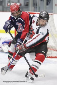

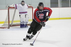

Hello Canon folks,
I thought I'd dabble at some sports work.  My friend plays hockey in a local rec league, so I thought I'd give that a go.
It's a small local rink, and I have free access to about 80% of the glass' periphery and can walk right up to the glass.  Also, being a new rink, the glass is nearly perfectly clear (though it does reflect lights).
Here's what I am doing...
Gear:
  • 5D3
  • 24-70 Mk I, 70-200 F/2.8 IS II
  • UV filters only (for front element protection), not using polarizers as I want as much light as possible
  • Not using hoods as the slightly elevated standing space behind the boards is really small and the hood would lean to a risky balancing act as it would push me back three inches from the glass.
Method:
  • Most of the shots are standing behind the glass in the corners of the ice, I can comfortably pan with the 70-200 or zoom out with the 24-70 to see from the entry of the zone to the net without hitting a glass seam.
  • Not using a monopod -- just handholding
  • Using IS mode 1 on the 70-200.  I'm not just panning at guys skating by.  Some guys are coming right at me.
  • I'm generally trying to freeze motion, so I've been in the ISO 1600-3200 range, and F/3.5 or so as both lenses sharpen up when slightly stopped down.  I'm happy to net 1/500s exposures, but would love to shoot more quickly if it didn't generate much noise or drive a softer large aperture.
  • Using level one out of three of high ISO noise reduction.
  • Shooting JPEG only to keep the buffer manageable -- more consecutive shots.
  • AI Servo used, chose mode 4 in the menu system.  Generally using the center point only, but I also use single point off-set right or left to track the puck handler with space in front of them, rule of thirds-style.... sort of.
  • As I am shooting JPEG, I'm using the florescent white balance as that's the lighting in this rink.
  • Pushing EV +1 to get the ice truly white (it's gray at normal exposure) -- this is like shooting snow, right?
Results:
  • I'm seeing a lot of slightly cloudy looking shots.  Levels work can manage some of this, but I'd like to get it right in camera if possible.
  • Much like shooting portraits of someone in front of the ocean, I often mess up and shoot out-of-level with the boards & dasher.  Any tips on this?  Monopod, maybe?
  • Sharpness is good, not great.  Nothing, not even still shots of guys at a faceoff, resembles the razor sharpness I see on a sports website.  Short of stopping down further, what can I do here?
Samples -- see attached / below.
...Now, please tell me what might put me in a better position to succeed!
Thanks, team.  It's awesome to learn from you all.
- A

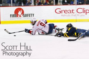

When I used to work for a university I shot hockey all the time the normal for us was 6400 iso, 1/800th and 2.8 a custom WB but every rink is lit differently and when shooting through the glass you need to be right on it almost touching it with your lens... I have a few shots attatched below shot with a 1D3 and 7D with 70-200L 2.8 and the 300L 2.8
