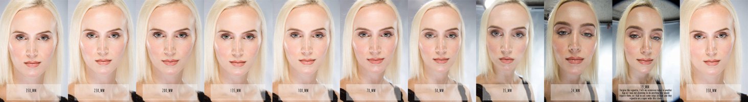

I saw this collection of faces...
I saved it because the person that did this ...did it right - IMO
I would give credit if I had the link...
this shot(s) explains a lot...

they really tell the story with these - IMO
The story of the first image: Model or Marionette?   :P

« Reply #6 on: November 28, 2012, 03:48:22 PM »
That's great, very telling.  Goes to show that there is no "best" focal length.  You learn the characteristics of wide vs. tele and then use the range for different artistic effect.  50mm is often claimed as the most natural, but since we are working in a visual medium, sometimes we want an interpretation different from "normal".  A classical portrait is usually more compressed than what we would see normally, whereas a wide angle shot can give a better sense of environment and "being there".  And as much as I love my 50, I'm not going to claim that it represents how I actually see things, since for better or worse I don't see things through a rectangular frame :)

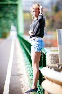

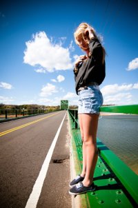

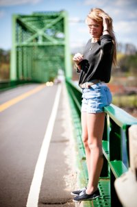

The wires over the model head are a no go in photography. Bad composition.

« Reply #13 on: November 29, 2012, 02:39:37 PM »
Perhaps it was included to show how wide "wide angle" really is?

« Reply #14 on: November 29, 2012, 02:49:17 PM »
Wires? You are looking at the wires?
Dude! Surely you can do better!
