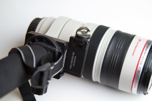

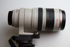

The OP's monopod thread mentioned a 70-200/2.8. I have a question for users of the CarrySpeed and/or SpiderHolster - how well do they work (if at all) when attached via the lens tripod collar?  Also, does the CarrySpeed plate twist?
The only method I can think of is to use the Spider clamp or the same Kirk clamps with the bracket or pin on the backside.  Still have that paranoid if it isn't tight fear though.
What do you mean by 'twist' with the CarrySpeed plate?
Makes sense, thanks.  Seems with the SpiderHolster, you'd just hang by the body plate, regardless.  Since I use an RRS L-bracket, I'll give their AS clamp some thought.
By twist I mean rotate in the tripod socket (it shouldn't do that).  The RRS plates/brackets have a lip that wraps over the edge of the camera bottom to prevent twisting.

Ah - the plate doesn't twist.

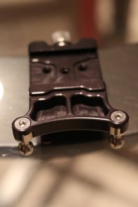

The CarrySpeed F-1 plate is all that and a bag of chips.  Only downside is the Arca 'length' is 1.75" long - I'd like a longer one.  This is the F-1 plate on a 100-400 sitting in a Wimberley Arca clamp, with the BlackRapid bit on the side.
