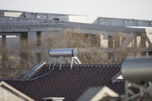

Hello,
I have a 5d III and the 300mm 2.8 II.
According to test this combination should crate fantastic sharp photos, but I have really big problem that to get sharp pictures.
I normally use the center focus point as single focus point.
I realized that objets that are more than 10 - 15 meters away the hit rate is very low.
I did go through the AF menu from A-Z but I found no solution. AFMA made everything only worse.
I attached one picture of many, that are all no really sharp. ISO 100, 2.8 1/4000
Does anyone of you has similar problems. With my other lenses I never had such problems (70-200 2.8 II, 24-105 4, ...)
Thank you.
Best Regards,
Flo

Hello Flo!
Thank you for adding this one photo.
The quality of light seems to be mostly left-sided-front-light that gives less contrast to your exposure.
As also mentioned by an other forumposter the dept-of-field is really thin using a 300mm with wide-open f/2.8 on a full-frame-camera.
If you examine your photo you can follow WHERE the focus are locked - look at the cliff and the dry-vegetation and tree branches and grass.
If this was my photo I would have photographed it in .CR2 (RAW) and then doing sharpening in DPP and maybe making other adjustments in order to get a out the most of this photo of the "Lion-King!"
What I have experienced is that my .CR2-files directly from 5DMKIII are dramatically sharpened by simple small adjustments using Canons own DPP.
Maybe you could try to re-adjust your wild-life photographing!
Also how do you point your AUTOFOCUS and do you LOCK the focus for example on the eye of the animals?
Be sure that your focus-lock-point is absolutely placed on the critical area of your main subject in your exposure. And maybe also do a re-exposure even a as a second exposure of the same view in order to have your Keeper when you examine your files at home after your photo-sessions - the memory cards do have a lot of space today! :-)
Your equipement are really really high-quality and should not make you disappointed!
How about a calibration-check at the Canon´s own service for both your DSLR with the particular lens together and yes to upgrade the lens to its latest updated firm-ware!
I really wish you Flo the very best solution for your excellent combination of equipement!
Happy New Year 2013!
All the Best!
/Charl

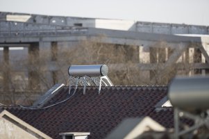

Thank you AlanF. I have already the update to Firmware 1.1.1.
On the 5D III I also have the newest firmware 1.1.3 too.
@ZoeEnPhos. Thank you very very much for so many useful hints and suggestions.
Just for your information:
I did do today several test shots just out of my windows (open window). With tripod, with out tripod (deactivated IS) and with f2.8 or f5.6 or f8.
But only 1 of 10 shots in Lightroom with 1:1 or 2:1 did look fine for me. f5.6 or f8 did not improve anything.
I hope you can still recognize that the photo 7006 is much sharper than the 7018.
I would say from 60 tries 5 0r 6 are like 7006 the other are like 7018.
---- forgot, the focus was in the middle on the black ground part with the letters.
Perhaps it is really my own fault.  :-[
On the other side I am lucky, because I have two Canon service center in the city  :) where I can let check the lens and the cam.
Thank you very much for your help and happy new year to you all.
Flo
