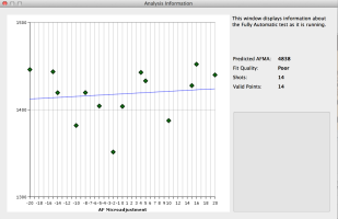

Hello everyone,
I just started using the Mac beta of FoCal with my 6D.  It worked swimmingly with my 70-200mm f/4L IS, and after 4 or 5 tries with my 50mm f/1.4.
However, with my 40mm STM, it has not worked at all.  The COF during the focus consistency check is 97.1%.  The analysis is all over the place though.
Has anyone got a 40STM to work properly with FoCal?  If so, did you have to do anything special to get it to work?

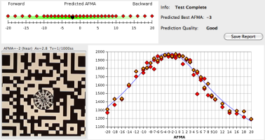

I started calibrating my lenses on my 1D X before it was supported, and I had to use Manual Mode.  I found that easy enough, so I've done all my lenses that way (if full auto was supported, I'd do that, but I can take my 83 shots in ~10 minutes, and that's about how long the MSC mode took the one time I tried it).
Here's the 40/2.8 on the 1D X at 50x focal length (Manual Mode analysis on the Mac version).  Note the 1/1000 s shutter - I find that a stable setup (solid tripod, ideally on a concrete not wood/carpet floor) and LOTS of light are necessary for a consistent result - my tests are generally in the 11-12 EV range.

« Reply #3 on: January 08, 2013, 12:22:35 PM »
Thanks for the help Neuro.
I'm running EV 8.5.  I'll boost my lighting and try again tonight.   I'm also going to try manual mode.
