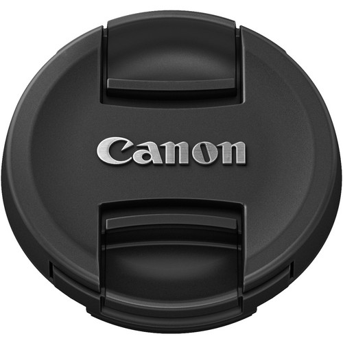

May 24, 2013, 08:50:40 PM
Author Topic: Canon lens caps SNAP-ON style!  (Read 2270 times)
Canon lens caps SNAP-ON style!
« on: January 11, 2013, 01:05:41 PM »
neuroanatomist
  • 1D X
  • Posts: 8665
    • View Profile
Re: Canon lens caps SNAP-ON style!
« Reply #1 on: January 11, 2013, 01:27:08 PM »
If anyone cares, these are not the authentic Canon MkII center-pinch caps.
Fake (from the links above):
Real (from B&H):
EOS 1D X, EOS 7D, and lots of lenses
_____________________________
hemidesign
  • PowerShot G1 X
  • Posts: 57
    • View Profile
Re: Canon lens caps SNAP-ON style!
« Reply #2 on: January 11, 2013, 01:36:30 PM »
You're right.. IMO the fake ones looks really good (design) and has the lens cap cord .. I'll take the fake for sure..
AND depends how much you wanna spend.. 10 bucks for the original or less than 2 bucks for the fake one..
rpt
  • 1D X
  • Posts: 1362
  • Could not wait for 7D2 so I got the 5D3
    • View Profile
Re: Canon lens caps SNAP-ON style!
« Reply #3 on: January 11, 2013, 03:10:52 PM »
You're right.. IMO the fake ones looks really good (design) and has the lens cap cord .. I'll take the fake for sure..
AND depends how much you wanna spend.. 10 bucks for the original or less than 2 bucks for the fake one..
If you notice, they have strings attached ;)
Dylan777
  • 1D X
  • Posts: 1594
    • View Profile
Re: Canon lens caps SNAP-ON style!
« Reply #4 on: January 14, 2013, 09:11:11 AM »
Since I'm using B&W clear filter as a lens protector, there is no lens cap in my bag :o
« Last Edit: January 14, 2013, 10:27:17 AM by Dylan777 »
Body: 5D III & Sony RX1
Lens: 40 f2.8 STM --- 50L --- 16-35L II  ---  24-70 f2.8L II  ---  70-200L f2.8 IS II
DJL329
  • 7D
  • Posts: 430
    • View Profile
Re: Canon lens caps SNAP-ON style!
« Reply #5 on: January 14, 2013, 11:00:10 AM »
I bought some of them a few years back and the paint on "Canon" rubbed right off.  Piece of crap.
Canon EOS 5D Mark III | EF 14mm f/2.8L | EF 28mm f/1.8 | EF 50mm f/1.4 | EF 85mm f/1.8 | EF 100mm f/2.8L IS Macro | EF 300mm f/4L IS
Marsu42
  • 1D X
  • Posts: 2815
  • 60d / 100L / 70-300L / 17-40L / 600rt / 430ex2
    • View Profile
    • 6D positive spec list
Re: Canon lens caps SNAP-ON style!
« Reply #6 on: January 14, 2013, 11:37:36 AM »
If anyone cares, these are not the authentic Canon MkII center-pinch caps!
@$1.45 no one probably though so anyway knowing the Canon prices for pieces of plastic - but didn't stop me from ordering some since I've got the time to wait for the delivery. But concerning the product infringement an absolute shame of course :-p
Re: Canon lens caps SNAP-ON style!
« Reply #6 on: January 14, 2013, 11:37:36 AM »
thepancakeman
  • 7D
  • Posts: 341
  • There are absolutely no absolutes.
    • View Profile
Re: Canon lens caps SNAP-ON style!
« Reply #7 on: January 14, 2013, 11:40:09 AM »
I bought some of them a few years back and the paint on "Canon" rubbed right off.  Piece of crap.
I'm fairly sure the Canon logo does not substantially add to it's ability to protect the lens.   ;)
Did the cap itself stay in place and do it's job, or it didn't do that either and hence the POC rating?
7D, 40D, XTi, 24-105 4.0L, 70-200 2.8 IS L, 85 1.8, 50 1.8, 100 2.8 macro, Tamron 17-50mm f/2.8, and an S100 that is more complicated than any of them.
candyman
  • 6D
  • Posts: 502
  • 7D wBG
    • View Profile
Re: Canon lens caps SNAP-ON style!
« Reply #8 on: January 14, 2013, 11:56:43 AM »
I just got my first 2 MK II lenscaps (77mm) before this weekend.
What a difference compared to the MK I lenscap. I love it !!!
It is so easy to snap on and off the lenscap while the lenshood is on. And, it doesn't slip out of my fingers anymore..
Still waiting for 2 x 67mm and 72mm....it seems difficult to deliver
5D III wBG
DJL329
  • 7D
  • Posts: 430
    • View Profile
Re: Canon lens caps SNAP-ON style!
« Reply #9 on: January 14, 2013, 12:16:20 PM »
I bought some of them a few years back and the paint on "Canon" rubbed right off.  Piece of crap.
I'm fairly sure the Canon logo does not substantially add to it's ability to protect the lens.   ;)
Did the cap itself stay in place and do it's job, or it didn't do that either and hence the POC rating?
A third party lens cap without a logo can easily be had.  However, if the reasons for buying one also include having the Canon logo on it, then it fails miserably.   Ergo, it's a piece of crap.
Canon EOS 5D Mark III | EF 14mm f/2.8L | EF 28mm f/1.8 | EF 50mm f/1.4 | EF 85mm f/1.8 | EF 100mm f/2.8L IS Macro | EF 300mm f/4L IS
awinphoto
  • 1D X
  • Posts: 1780
    • View Profile
    • AW Photography
Re: Canon lens caps SNAP-ON style!
« Reply #10 on: January 14, 2013, 12:44:16 PM »
If anyone cares, these are not the authentic Canon MkII center-pinch caps!
@$1.45 no one probably though so anyway knowing the Canon prices for pieces of plastic - but didn't stop me from ordering some since I've got the time to wait for the delivery. But concerning the product infringement an absolute shame of course :-p
i got tons of these cheapie caps...  If one gets misplaced, i can replace them without fretting... they are tough... I can pick the camera and lens up by the cap and it doesn't give (for the most part)...  They got a crappy string attached to it, but I cut those off the day they arrive at my door.  Couldn't recommend them strong enough...
Canon 5d III, Canon 24-105L, Canon 17-40L, Canon 70-200 F4L, Canon 100L 2.8, 430EX 2's and a lot of bumps along the road to get to where I am.
Re: Canon lens caps SNAP-ON style!
« Reply #10 on: January 14, 2013, 12:44:16 PM »
