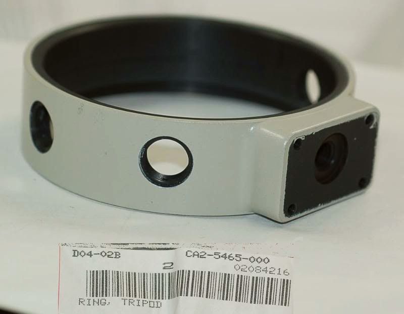

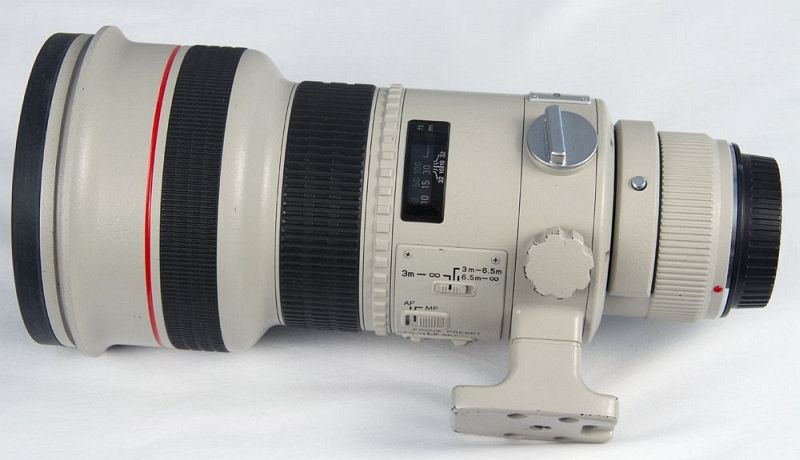

Anyone know where I can get one for the 300 2.8 canon?

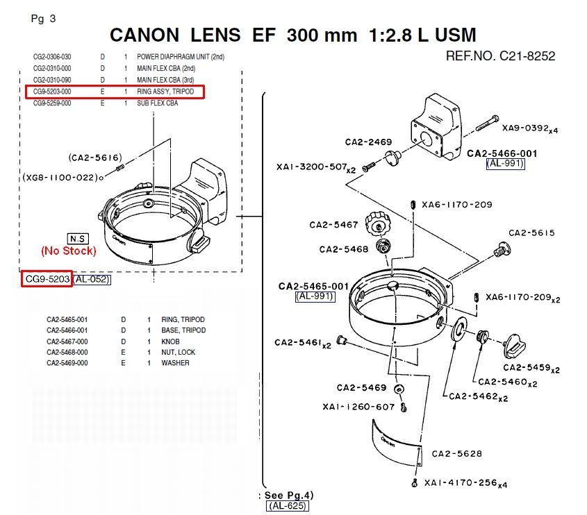

I don't think you will find a 3rd party option.  How did you get if off the lens? I assumed they were not removable.
Here is the Parts List: http://www.micro-tools.net/pdf/Canon/EF%20300%202.8%20L%20USM.pdf
There is "no stock" on the entire ring, but it looks like parts are available.
