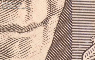

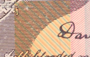

Here is my contribution I still maintain FF delivers noticably sharper images than 1.6 crop with current tech
(who knows what future tech will bring however apply the same tech advances to FF that you apply to crop and
FF will still be ahead. however I believe that the law of diminishing returns will apply soon and that in reality you wont be able to see the difference unless seriously pixel peeping
here is the comparison shots i did for another thread
5Dmk3 + 300f4L IS + Canon 2X mk3
vs
EOS-M + 70-200 f2.8L IS II + Canon 2X mk3
both at f8 shot on tripod in Live view and manually focused
I think we can all agree the 70-200 is a sharp lens with lots of resolving power
the 300f4L IS is a much older optical design
however the FF combo is noticably sharper
these are 100% center crops
APS-H Fanboy

I don't disagree, actually. When it comes to the FF vs. APS-C argument, assuming you compose the scene the same (i.e. get closer or use a longer lens to achieve same subject size in the frame), the higher pixel COUNTS of most FF sensors, along with the better performance of each pixel thanks to their larger size, definitely results in better IQ. This argument is better made in terms of pixels on subject rather than pixel density. Regardless of how big (or small) the pixels are, if you get more on subject, and get more better pixels on subject, then your subject overall will end up looking better. Assuming the same pixel performance between a 22.3mp FF and an 18mp APS-C (same amount of noise for any given exposure and ISO), if you frame the same subject the same size in the frame, the FF sensor should look about 24% better. It has 24% more pixels on the subject.
Now, assuming cost is no object, one can always pick up a 5D III, slap on a 600mm lens, and go zipping around photographing birds, wildlife, sports, air shows, whatever tickles your fancy and get better results than a 7D with a 400mm lens. You'll get roughly the same FF-effective FOV as the 600mm, but the larger, newer, better pixels of the 5D III, along with the fact that there are more of them in total, will just blow the 7D away.
The benefit of a high density APS-C really only comes into play when you can't afford that $13,000 600mm lens, meaning even if you had the 5D III, you could still only use that 400mm lens. Your in a focal-length limited scenario now. It is in these situations, where you have both a high density APS-C and a lower density FF body, that something like the 18mp 7D or a 24mp 7D II really shine. Even though their pixels aren't as good as the 5D III (assuming there isn't some radical new technology that Canon brings to the table with the 7D II), you can get more of them on the subject. You don't need to crop as much on the high density APS-C as with the lower density FF. On a size-normal basis, the noise of the APS-C should be similar to the FF, as the FF would be cropped more (by a factor of 1.6x), so the noise difference can be greatly reduced or eliminated by scaling down.
I challenge you to re-do your test with the 5D III and EOS-M. However this time, use the 300mm on both cameras, with the cameras at the same distance to the subject. The EOS-M should end up looking sharper on a size-normal basis (either scale its image down to a crop of the same area as the 5D III...or scale a matching crop of the 5D III up to the EOS-M image.) If you use the 300mm on both, and frame the subject in-camera the same for both, the 5D III again should end up being the winner because it gets more pixels on subject.

....here is the comparison shots i did.... the FF combo is noticably sharper...
Yes, but could you convince anyone that they were real?
vs
While I agree in principle that, out of camera and all other things equal, FF shots are sharper, you've got way too many differences in this test.
But even here, if you sharpen the crop sample they look identical. Sharpening is not an unlimited good, so as long as the gap between component A and B is below a certain amount, post processing can eliminate the gap. This is true FF v. crop at low ISO, but not at high ISO.
Quote
For testing purposes you can't make those kinds of assumptions. How do you know that your copy of lens A is sharper then your copy of lens B when used with your copy of teleconverter C at aperture D? Eliminate all relevant differences in the test to isolate the variable you're testing for.
But again I agree with the point. Out of camera, all other things equal, FF is sharper.
