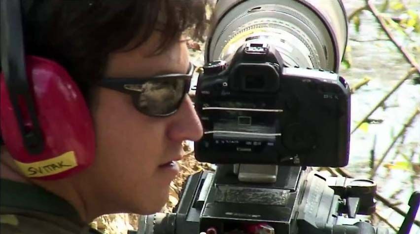

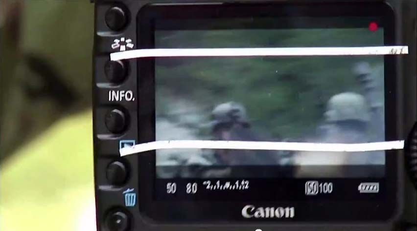

Here's some shots of them filming Act of Valor using 5D MkII's at 2.35:1 the simple way,
link to video here,
http://blog.planet5d.com/2012/01/act-of-valor-filming-with-a-canon-eos-5d-mark-ii-around-live-ammo/
cayenne
  • 5D Mark III
  • Posts: 693
    • View Profile
Re: Framing for 2.35:1 aspect ratio using a 5D3: Best methods?
« Reply #8 on: March 02, 2013, 11:13:52 AM »
link to video here,
I'll be darned!!  I wonder what kind of 'tape' they were using..something that wouldn't leave a mark when you took it off.
Is there a measurement you'd use on the screen on the back to know where to put the tape?
C
« Reply #9 on: March 02, 2013, 11:51:40 AM »
Quote
C
Looks like correction tape to me.  Great when you don't want to wait for white-out to dry.  Based on my experience, masking tape would be easier to remove without leaving residue, but you could probably clean off the correction tape with a combination of a fingernail and a damp cloth http://www.amazon.com/s/ref=nb_sb_noss_1?url=search-alias%3Daps&field-keywords=+correction+tape&rh=i%3Aaps%2Ck%3A+correction+tape

« Reply #10 on: March 02, 2013, 12:26:21 PM »
If you wanted it fairly accurate,
I'd suggest something like framing your cameras screen with a TV playing something 2.35:1,
or convert a clip of something to MOV and try playing it on your cameras screen.
I'd cut thin strips of white electrical tape, it should peel off easily and not too sticky.
Hope that helps.
