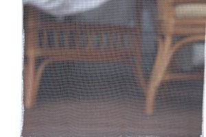

Is it normal for the 24-105mm f/4L to be a little soft in the corners when zoomed in to 105mm?  I snapped a shot of my screen door at f/7.  The screen mesh is crystal sharp in the center third, not too bad in the left third but a little soft in the right third and more so at the bottom corner.  At 24mm, the screen mesh looks crisp all over.  I just got the 6D and this lens a month ago and decided to do this test.  My question is should I send it in for adjustment, or is this normal?

After I made my post I started thinking about my set-up:  It was hand held and the focal plane may not have been parallel to the screen door.  So I did a proper set-up on the tripod and did some shots at wide open and with the zoom set  at both ends and the middle.  I got better results with the set up so that the focal plane was parallel to the wall.  I see a bit of softening at 105mm in the corners with the aperture wide open and down to f/7; aperture doesn't seem to matter, but by 70mm the image is tack sharp corner to corner.  24mm is very sharp.  I taped a cloth towel to the wall.  The fine fibers make for a good image to resolve.  I also found that when focusing manually, I did not get the image as sharp as the autofocus.  I appreciate what I am learning on this website.  I feel better about my new camera and lens after making this test.
Screens are notoriously undulating... and at the longer end of the zoom and if you are close enough perhaps MFD, which I suspect you are,  this would look even more uneven. This is why I prefer real world shots to access if the image is satisfying...not necessarily tack sharp...but sharp enough and pleasing and representative...don't take shots of brick walls and screen doors...you will never be happy.
Having said that, yes, the 24-105L can be a tad soft in the corners. From what I read here it seems to be uneven among different copies...my own is sharp on the long end and a tad softer in the corners at 24mm. But one doesn't notice this in real people shots.
All said, I still love the zoom.
