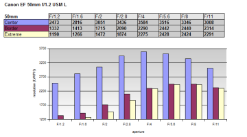

The 50L is the sharpest 50mm canon makes in the center from F1.2-2.8. If this fits your usage, I'd get one.
