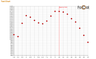

R1-7D
  • EOS 7D Mark II
  • Posts: 563
Re: Tokina 16-28mm FX Focusing Issue with 5D3
« Reply #11 on: March 28, 2013, 12:00:01 PM »
I just calibrated the new Tokina using Focal. The results are interesting compared the faulty version I had which seemed to go all over the place on the graph.
Old first, new second.
Mt Spokane Photography
  • Canon EF 5-1500mm f/1.0L IS
  • Posts: 13995
« Reply #12 on: March 29, 2013, 11:05:49 PM »
Wow, that first one had some severe problems.  I hope the 2nd one holds up better.  Keep us informed.
