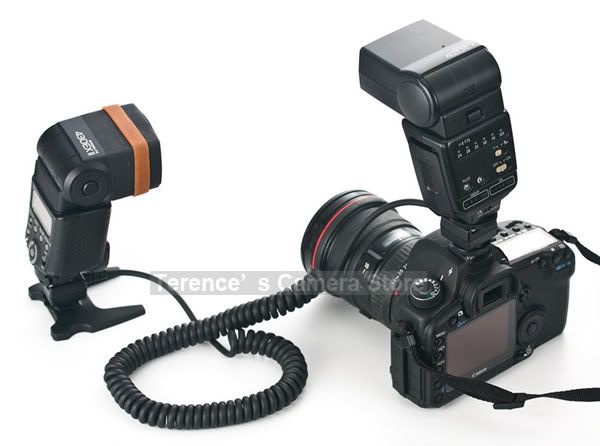

You mean like this (I am not affiliated with this seller)?
How does the camera knows which is the master? That cord seems to be ETTL, so both flashes are equal, I guess?

Yes that is what I meant, the 270XE II has a Slave mode on the power switch OFF-SLAVE-ON. But I thought it could also be used as a master, but I think I was wrong so back to the drawing board.
Some cameras can control the 270EX II remotely via their pop up flash, the 7D, 60D etc. The cheapest way to maintain full Canon functionality with the 5D MkII would be to get a secondhand ST-E2, but I don't know how you could separate the flashes into channels, they would both always fire at the same power.
Actually, I do not mind the same power as long as I can control it.

Sorry, no that is not what I meant. I meant one flash on the end of the ETTL cord as the master, the second flash just sitting by itself as a slave, that is what I meant by it having a SLAVE mode, it doesn't need to be connected to anything.
BUT, you can't fire the slave 270EX II with a 270EX II as a master, so my idea won't work. You need a 7D, 60D, 650D camera or 550EX, 580EX, 580EX II, 600EX or ST-E2 flash to act as a master to fire your remote slave 270EX II.
Thanks, I get it now. I guess the YN ST-E2 might be the answer.
