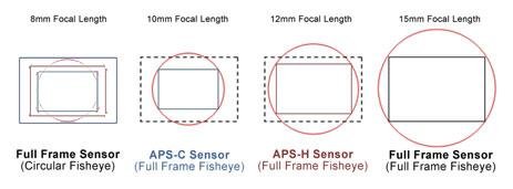

I'm not really sure why people are so excited about this lens.  I honestly don't know much about this lens, so correctly if I'm wrong.  On a crop body it gives you a 180 view at all focal lengths?  And on a FF body it allows you to do a fisheye at the lower end and 180 degrees only at 15mm?
Thanks!
neuroanatomist
  • CR GEEK
  • Posts: 22827
Re: The EF 8-15 f/4L Fisheye Has Landed
« Reply #8 on: July 28, 2011, 11:48:21 AM »
You're getting 180° at all focal lengths on all sensor formats.  The difference is that on non-FF cameras, you get 180° diagonal AoV that fills the frame (at 10mm for APS-C and 12mm for APS-H).  If you go wider than that on those formats, you get vignetting around your image (i.e. part a circle).  On a FF camera, at 8mm you get a circular fisheye, with 180° coverage all the way around (vs. just diagonal, which is the longest dimension of the sensor).
So basically, you get 'full frame fisheye' coverage for any sensor size (as opposed to the EF 15mm f/2.8 Fisheye, for example, where you get 'full frame fisheye' only on a FF sensor, and a cropped, less fishy version on smaller sensors), and on FF you also get the option of a true circular fisheye.
Below I took Canon's example of the different coverages and superimposed the APS-C and APS-H sensor sizes onto the FF circular (8mm) setting, to give an idea of what vignetting would be like.  On the lens itself, Canon added a zoom range limiter for APS-C and APS-H to allow you to easily avoid going too wide.

« Reply #14 on: July 29, 2011, 08:25:29 AM »
really only good at 15mm on the 5DII
How do you figure that?
If you actually want a 180° FoV all the way around, you need to go to ~8mm on FF, for example the currently available Sigma 8mm f/3.5 EX DG circular fisheye (or the manual focus Pelang version).  Canon used to make one, too - the old Canon FD 7.5mm f/5.6 Fisheye
As shown in the diagram I posted above, a lens like the EF 15mm f/2.8 Fisheye, which is a 'full frame fishsye, ' provides 180° FoV on the diagonal only - the horizontal FoV is 147° and the vertical FoV is 94°.
So, I'd argue this lens is most useful on a FF camera like the 5DII - on APS-C and APS-H you just get a full frame fisheye, whereas on FF you a full frame fisheye at 15mm and a circular fisheye at 8mm.
