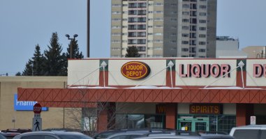

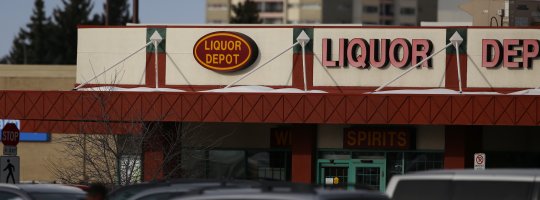

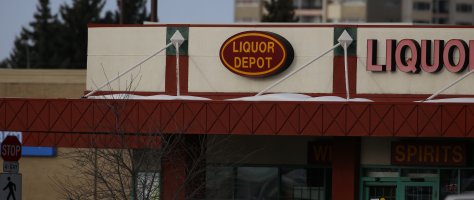

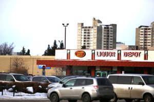

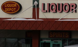

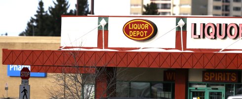

I understand the moon isn't the best sample but it was a perfect night for clarity FWTW.
Because I have modest means I did my best to check things out at the photo shop before purchasing and here are some comparitive shots we did.  I've cropped to decrease the file size and downsized as little as possible in a couple that were over 4 MB.  The shots are with the 300 F2.8 II plus extenders and the other is the D5100 with 70-300 @300.  Shouldn't I be getting better relative to the D5100 with the Canon 6D and these expensive lenses??
Jack

« Reply #11 on: April 14, 2013, 02:12:14 PM »
300 F2.8 II

« Reply #12 on: April 14, 2013, 02:16:35 PM »
300 F2.8 II and 1.4 III

« Reply #13 on: April 14, 2013, 02:22:21 PM »
300 F2.8 II and X2 III

BTW Focus was on "Liquor Depot".  Now that I've posted this I sense that I should have started a new thread - my appologies.  I'm new to this and my thought was simply to make contact with bdunbar79.  Feel free to clue me in if I've committed the unpardonable sin  :-[
