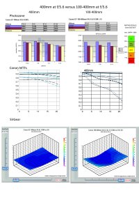

It is frequently asserted that the 400mm L f/5.6  is very sharp and a much better lens than than the 100-400mm L IS. As someone who has used both, I know that they are of very similar sharpness, and they are not as sharp as sometimes stated. So, here is a summary of quantitative measurements of both from three very reliable sources: Photozone, SLRgear and Canon MTFs. In all cases, the 100-400mm is at least as sharp in the centre, which is what counts if you are using them for bird photography. For the fun of it, I have also compared them with the now out-of-production Sigma Apo Tele Macro f/5.6. Whereas, the two Canon lenses hover in the "very good" category of Photozone, the Sigma reaches the excellent - and it really is much better. If Canon had put in some effort, they could have made a super sharp 400mm f/5.6, preferably with IS. I wonder why they never did?

There would be no difference in length and width, just a few extra small pieces of glass inside.  Sigma gave up their superb 400mm prime in favour of much heavier and optically inferior zooms.  Maybe both Canon and Sigma think the market is not there for a 400mm f/5.6? There are rumours of new 400s from Canon in the offing. We shall see.

For good measure, here is TDP's comparison at f/5.6:
http://www.the-digital-picture.com/Reviews/ISO-12233-Sample-Crops.aspx?Lens=278&Camera=453&Sample=0&FLI=0&API=0&LensComp=113&CameraComp=453&SampleComp=0&FLIComp=7&APIComp=0
The prime beats the zoome at the corners pretty consistently, but in the center, it is darn near dead even.  Plus, the zoom has IS and 100-399 mm.  I find even the 2 stops of IS on the current version to be very helpful and while I probably use my 100-400 @ 400 mm 80-90% of the time, but when I want that other range, it sure is nice to have.
As with many others, I would love to see a replacement for the 100-400L.  If they give it 4 stop IS, complete weather sealing, and get is sharpness to rival the 70-300L or the 70-200 mm f/4 IS....I am absolutely willing to pay a premium.
Until then, I am happily taking pictures with my 100-400L.
