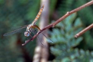

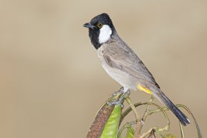

I've only been using the Better Beamer for less than 2 months (I've heard of it through neuroanatomist in CR) and I'm really impressed with what they can do. When I'm shooting with my 5D MK III + Sigma 150-500 OS, I use 600EX-RT speedlite ... I highly recommend it, it is just awesome. When I shoot with Nikon D7000+300 VR (which I carry everyday due to convenience of not having to change the lens) I use Yongnuo YN568EX - its a decent speedlite for under $200 and does a pretty good job.
Here are a couple of shots:
1st one using Canon 600 EX-RT + better beamer on 5D MK III & Sigma 150-500 OS at 500mm
2nd one using YongnuoYN568EX + better beamer on Nikon D7000 & 18-300 VR at 300mm
