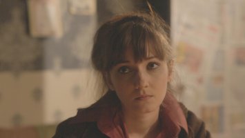

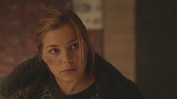

Dear Friends,
Have just shot some footage using Canon 5D Mark III @ 500 ISO(!), 1920 x 1080 ALL-I, ZEISS ZE-series lenses.
Here are the grabs from the footage while playing in QuickTime.
Shot in Technicolor Cinestyle profile. No editing/grading whatsoever.
The question is - how come the noise is so bad?
1. Could I mess up the settings?
2. Is it a sensor issue (i.e. technically bad performance of the sensor itself)?
3. Could it be the Firmware issue?
4. ???
5. ???
Any word of advice is absolutely precious.
Thanks from Moscow, Russia.

« Reply #1 on: April 23, 2013, 07:55:02 PM »
I don't do video, but a couple things stand out.
First, as I understand it, Cinestyle is intended to be a very flat, low-contrast space optimized for later post-production. Before worrying about the visible noise -- and, yes, it is visible -- first see if it remains visible after you've performed your standard post-production. It may well be a non-issue for the final print, even if it's annoying right now.
Next, in a similar vein...it sure looks awfully dim to me. That may be what Cinestyle does, but my gut tells me that the intended use instead is that you'd shoot for a much brighter image and then compress the shadows to get your contrast, rather than to expose for the shadows and expand and lift them for detail.
Did you use some sort of a standard calibrated reference to set a proper exposure, such as a light meter or a chart or a test pattern? If not, I would absolutely do so before doing any other tests or investigation.
Regardless, I can all but guarantee you that it's a technical problem with your setup or workflow. I've seen samples of the 5DIII shot at much higher ISO settings that don't have anywhere near the noise in your shots; the problem isn't with the camera itself.

« Reply #2 on: April 23, 2013, 09:19:52 PM »
Dear Friends,
Yes. Your settings are most likely the problem. For video, the general rule is to use ISO multiples of 160: 160, 320, 640, 1250,... These are the low-noise ISO's for video. You are likely to have much less noise at ISO 640 than at ISO 500. In fact, ISO 640 is less noisy than ISO 200 for video.
Also, make sure that you have disabled Highlight Tone Priority (set it to OFF in the third camera menu).
Cinestyle is fine. You might also try Neutral (0,-4,-2,0).
See this video: 5D Mark III ISO Noise on Vimeo

As jason said... the multiples of 160 is a must for reducing noise on video...
Also I'd question using Cinestyle if the framegrabs you've posted are typical of the material. Cinestyle does give you more DR than the Canon picture styles, but at the cost of making all your blacks grey and people look slightly clay-like.
You're frame grabs don't look like they have an awful lot of DR in them - so by using a picture style which compresses colour data (and with 8 bit colour we don't have much to work with anyhow) you actually have less data to work with than using other styles.
Consequently I'd recommend either using neutral, or looking at the Flaat or VisionColour picture styles which both give Cinestyle-like DR but without some of the drawbacks.

« Reply #4 on: April 24, 2013, 02:10:33 PM »
Cinestyle tends to really bring out the noise, I used it on one shoot and never used it again.  Honestly the grabs don't look that bad, but like Jason said you should be using ISO's in multiples of 160, they tend to produce the least noise.  And if you check his video out you'll notice that ISO 500 seems to be a sweet spot for terrible noise (640, 800 and 1250 seem to have less).

The Mark III has a lot of noise in the shadows (high read noise) at low ISOs. 500 ISO is a digital push, brining the blacks up. Cinestyle further raises the blacks.
This looks underexposed. Did you meter correctly? Not in-camera but through an incident meter. The internal meter is not accurate for cinestyle. Looks nicely lit and composed, but the underexposure will get you. HTP further exacerbates this issue, and it's there to some extent on all Mark III video, even raw.

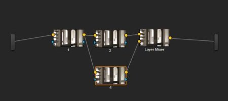

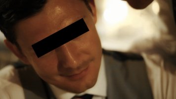

I think I have the same problem.
ugh.
I had been playing with Marvels Cinestyle..and early test seemed to show if I slightly underexposed I had lots more room to try to use Resolve to bring up exposure, and get good color saturation, etc.
I'd gone through my whole video on Davinci Resolve (edits done on FCPX), and it looked great.
I brought it back to FCPX...and most of it looks good, except anywhere with dark/black is highly noisy, I mean really bad.
I can't seem to find a happy medium. When I exposed in camera for proper exposure, it always seems things get blown out, so, I tried underexposing by about 1 stop on everything...but now full of noise.
I didn't think the 5D3 had noise problems till you got in high ISO? Or is that just with stills?
I shot everything in multiples of ISO 160, trying to keep  it below 800 -640 as a last ditch high value...most of it was 480 and below.
*sigh*
this is getting frustrating, I desperately want to try to shoot with a cinestyle and learn color correction and color grading, and get great images like I've seen others get out of the 5D3, but I've not hardly gotten anything near what the baked in Canon Styles seem to result in....I just don't know what I'm missing.
I have all my lights matching color temp, I have decent lighting, good WB...and yet, my images look like they came out of an early edition iphone or something.
