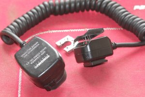

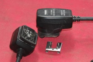

I recently ordered a Yongnu OC-E3 ettl cord from the other side of the world because it's so much cheaper than Canon. After some time having it on a flash bracket the metal base plate on top of the adapter where the real flash goes started to wobble, and recently it came completely off - the metal screws with the hotshoe were torn out of the plastic plate.
This doesn't come as a complete surprise since having a heavy 600rt flash mounted in an angle and walking around with this puts quite a torque on the base plate of the ettl cord...
... My question is: Is the Canon original any better, or are there sturdier 3rd party oc-e3 ettl cords? The Yongnu otherwise is fine, but the metal screws into plastic is just cheap and cannot take any strain at all (at least my copy).
Edit: Added pictures with torn off base plate
« Last Edit: April 25, 2013, 07:42:28 AM by Marsu42 »
My 3rd-Party cord had a similar problem, a bit of 2k-glue proved to be a much sturdier connection then those fine threads in plastic. (I don't think it would ever come apart even if I wanted it to do :) )
Good idea, I'll glue it together again, too :-) ... and since the Yongnuo OC-E3 is €10 and Canon is €60 I can live with it, though I would be doubtful to use it in critical situations like a wedding.
