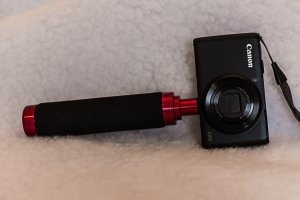

My first suggestion would be a monopod - it doubles as a club for when you get out of line. :) A $1 alternative is one of these $1 Image Stabilizer For Any Camera - Lose The Tripod/Monopod - I find this works quite well.
More seriously- If you don't want a monopod, f/2 means more that $400. You might get a used Fuji X100 for around $600 - $650. This is at the upper end of fitting in a handbag but it's a really nice camera.
Alternatively, if you're after something with zoom, look for a combination with an effective IS (but you're looking at a lot more money too.) Be aware that a $100 lens will not get you 4 stops of image stabilisation.

My first suggestion would be a monopod - it doubles as a club for when you get out of line. :) A $1 alternative is one of these .... $1 Image Stabilizer For Any Camera - Lose The Tripod/Monopod[/url] - I find this works quite well. ...
+1 to the monopod and +1 and an "I'm going to make one of those" for the $1 alternative.  (I'll do a lashing too since since I'm an Eagle Scout as well.)
I've used one of these before to get a better grip:
http://www.amazon.com/gp/product/B005MZO5TA/ref=oh_details_o08_s00_i00?ie=UTF8&psc=1
