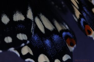

I used all three Kenko tubes and the 100mmL IS to take the attached picture.  The distance was under three inches.
Focusing is not terribly easy, just takes a steady tripod and a bit of patience.

 what exactly am I looking at?

That image looks like a butterfly wing to me.
Middle East excavation site in progress.
What I do is I take photographs to point the exact position of artifacts in relation to eachother and the site (don't necessarily need tubes for that).
I further take closeup photographs of artifacts that are scuffed, broken - likes pieces of a mosaic floor that look the same - in order to get clues for 'puzzling'. Pieces are like 1 cm and very often part of floors of 3 square meter and larger
