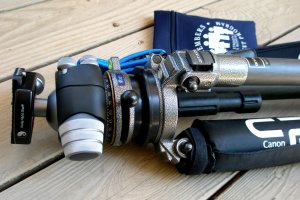

Yes, Sir, + 1 for me too, Dear Mr. Neuroanatomist.
I  Use Similar Tripods, Leveling  and Heads  that you recommend and I love them.
But, When I fly, I use Difference Set. $ 150 US Dollars Made in China, Carbon Fiber Tripods/ Monopod, that can Carry 20 Pounds Load, and Light Weight that Fit  to Side pocket of My Back Pack.
http://www.cowboystudio.com/product_p/bk-586.htm
Surapon
