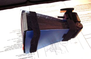

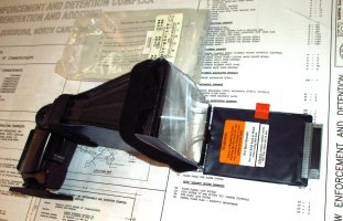

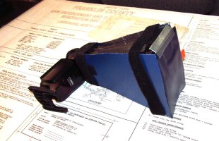

2. the Better Beamer is great, but the Fresnel lens is like a huge magnifying glass and will burn holes in your gear in bright light.  Seriously.

Dear Friends.
As My Professional as Architect in NC., USA, And Photography just my pass time Hobby, Yes, I love to improve any equipment that I have. Including the" Better Beamer " too---When I use with my 600 mm + 2X  at the tree under the shade , and Try to shoot the Bird at 100 feet or more---The Better Beamer  with Flash not long range enough. I just add the  Aluminum tape ( for HVAC Duct Tape) to the Better Beamer Panels and Add two Rigid Plastic Panels on top and Bottom with the Aluminum Tape too---Yes, I add Velcro to the Plastic envelope to  the Front of Lens , When I do not use---As the Cover Lid. ( to not let this strong  flash light damage some one eyes or let the sun ray to burn the flash unit)---Yes, This Add On Reflector = add double light from flash pass thru the Lens. Yes , I can add more ( almost Double Distant ) distant of flash for my 600 X 2 = 1200 mm Lens.
Yes, It's works.

Many animals do not mind the use of a flash, the big cats seems almost bothered by it, but NEVER EVER use a flash with an African elephant, they do not take to it kindly.
The Better Beamer is very good, but be careful with sunlight being focused on your Lenscoat, or even the flash body or camera body.
I have had smoke, and melting, from the Lenscoat and have melted 580 flash bodies with the sunlight being focused on them.
