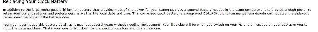

 Check the voltage of the backup battery(C1616) to make sure that it is in working order or else get it replaced . See if it helps.
« Last Edit: September 01, 2013, 10:39:33 PM by sama »
