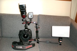

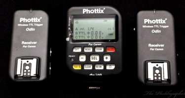

Dear Sir.
Past many yeas, For my traveling Portrait and Wedding Job, I use my DIY Multi-Flashes  System--That I make the Side Light  = Flash + Graslon 4100F,  And Catch Light/ Top of Camera for Indirected Light with Sto-Fen Omni-Bounce-With Aluminum Reflected Tape on the Back of Sto-Fen----Yes, This My DIY is work  for me Perfected Portrait Photos in every Times---Yes  I use One of the Best E-TTL  Wireless Controler too---For Fast walk around shooting  with out thinking--Yes, Lazy/ Stupid Me = I set up my Canon Cameras in PROGRAM MODE and Get 99% good/ Great Photos---With out use my brain and my hands setting the camera for 1000  + photos on the wedding job/ Party Job.
Just My Crazy Ideas for this DIY, and hope that you might like this DIY.
Enjoy
Surapon
http://www.dpreview.com/articles/0304434791/accessory-review-phottix-odin-ttl-flash-trigger-for-canon-

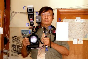

surapon
  • Canon EF 300mm f/2.8L IS II
  • Posts: 2958
  • 80% BY HEART, 15% BY LENSES AND ONLY 5% BY CAMERA
Re: I need some flash advice...
« Reply #14 on: September 14, 2013, 12:06:41 PM »
A= MONO-POD
B= CUSTOM BRACKET FOLDING " T"
C= RPS STUDIO, MODEL RS-03102 MULTI-FLASHES HOLDER.
D= HARDWARE CRAMP.
E= DETACHABLE BASE AND HOTSHOE MOUNTED.
F= CANON FLASH 580 EX II
G= GRASLON 4100F, FLASH MODIFIER--MAIN LIGHT = BIG SOFT LIGHT WITH MINIMUM SHADE AND SHADOW.
H= PHOTTIX ODIN, TTL + TTL ii FLASH CONTROLER/ WIRELESS TRANSMITTER FOR 3 GROUPS 12 FLASHES.
I= PHOTTIX ODIN- TTL + TTL-ii FLASHES RECEIVERS.
J= CANON FLASH 580 EX.
K= STO-FEN OMNI-BOUNCE( diy MODIFY) FOR CATCH LIGHT AT EYES OF MODELS.
L= CANON 5D MK II AND CANON LENS EF 24-70 MM. F/ 2.8 L USM.
M= CANON OFF-CAMERA SHOE CORD TO LINK CAMERA AND PHOTTIX ODIN TRANSMITTER
