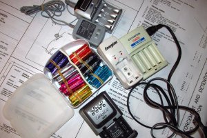

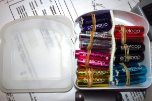

Last years, I am very luck to buy 4 packs of Eneloops( 1 pack = 8 Batteries) from closed( Bankrupted) Ritz camera stores---The Reg. Price = $ 24.99 Per pack of 8 AA., Finial Sales price =$ 6.25( at 25% of original cost), and use my Old Chargers---Out put from 200 mA ( the slowest charger-over night) to  out put 1500 mA super Fast Charger.
Yes , When I have the time, I use slow charger, But When I am in hurry, I use the fast charger.
So far, It work great for the Awesome  Eneloops.
Nice to talk to you.
Surapon
PS. I buy the Sandwich Plastic Box = $ 1.00 US Dollar from Walmart  to keep my Eneloops, and use the rubber strip to separated between them.
