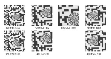

The TDP tests of the 100-400mm with the and without the 1.4xTC appear to show that the 1.4xTC lowers IQ significantly. However, these tests are not really right for what we want. Bryan uses the 1.4xTC set up 1.4x further away so the chart fills the whole screen. What we want to know is what the image looks like from the same distance away, and also the chart filling only part of the centre of the screen so we can see more easily the fine detail of the images. So, I took some photos of the standard chart (standard 600 dpi  printout, not the high resolution) in September, from the same distance for three combinations:
Top: 5DIII + 300mm f/2.8 II + 1.4X TC III at f/4 @420 mm
Middle: 5DIII + 100-400mm at f/5.6
Bottom: 5DIII + 100-400mm + 1.4X TC III at f/8 @550mm.
In the next post I'll show just the very centres further away, at the limits of resolution.
All are 100% crops, with no sharpening or noise reduction other than what comes out of RAW.
There is not much difference on adding the TC
5D IV, 5DS R, 400mm DO II, 1.4xTC III, 2xTC III, EF 1.8 STM,  EF 24-105, 100-400 II, EF-S 15-85, Sigma 150-600mm C, EOS-M5 15-45, f/2 22, 11-22, Samyang 8mm f/2.8 fisheye: sold 7D II, EOS-M, Powershot G3 X,  Sigma 10-20, EF 300/2.8 II, 70-200/4 IS.

I moved to about twice the distance so the centre circle were only partly resolvable. These are 100% crops, but the pixels of the shot without TC were increased by 1.4x to give the same "resolution" as with the TC.  Judge for yourself. Is it worth losing a stop and spoiling AF by adding the TC? (My lens is sharpest bare at f/11, similar to as found by SLRgear.
Top = bare lens x 1.4 using PhotoShop
Bottom = lens + 1.4xTC
« Last Edit: October 25, 2013, 11:36:23 AM by AlanF »

I moved to about twice the distance so the centre circle were only partly resolvable. These are 100% crops, but the pixels of the shot without TC were increased by 1.4x to give the same "resolution" as with the TC.  JUsge for yourself. Is it worth losing a stop and spoiling AF by adding the TC? (My lens is sharpest bare at f/11, similar to as found by SLRgear.
Top = bare lens x 1.4n using PhotoShop
OK. So basically upping the resolution in photoshop will result in almost a same image as using the TC  :(
