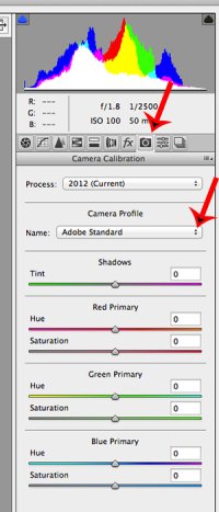

No don't use the two white balance sliders. In Adobe Camera Raw, ACR, you need to go to the Camera Calibration tab, click on that and you get the panel below. I have arrowed the camera calibration tab, and the sub tab where any new profiles will reside, having said that if you click on that second tab you will find Adobes version of Canons Picture Styles. Try them, some are much less magenta/red.
