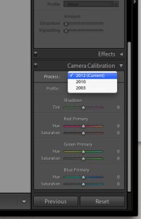

You can use any process version you want in newer software. Upgrading from a LR3 catalog to a LR5 catalog will not change the process version of the images you already have. You can choose to, and if you do you will get probably a stop more usable shadow detail (if that isn't worth less than $100 I don't know what is!), but you don't have to.
In the Develop module just go to Camera Calibration-Process: and click the little arrows next to 2003/2010/2012 and just like all Lightroom edits, it is non destructive, you can change to any version any time you want to.
