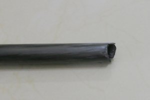

Gentlemen ... need some help:
While capturing some video footage of our brand new offshore rig, my Manfrotto 055CXPRO4 (with 5D MK III + 16-35 L II on it) had a very bad fall, (got flung out over 10 feet from a 6 foot height), due to an oversight on my part ... camera has a couple of tiny scratches and the B+W XS-Pro filter is totally cracked ... I broke the filter glass with a small Plier, as the filter has a dent which did not allow me to remove it - basically stuck and I had to continue shooting or miss the footage ... anyway that's for another thread ... please refer to the images below to see the broken tripod leg (its the last tube on the tripod) ... I can still use it if I insert it back and lock it down, but I prefer that it is replaced ... anyway, I checked the net for a replacement leg and found the attached pdf in Manfrotto website, but I cannot figure out which part is the correct one ... does anyone know which part I should be ordering?
Appreciate your help as I've got an important vacation coming soon and I really want my favorite tripod working like it used to a few hours ago.

R055,620 is the bottom leg section.
From biggest to smallest the leg section numbers are R055,617 - R055,618 - R055,619 - R055,620.
« Last Edit: November 09, 2013, 12:19:50 PM by privatebydesign »
Thank you very much ... most appreciated.
