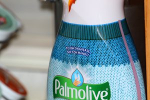

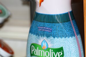

I know this horse has been beaten over and over but I can't seem to remember ever seeing a side by side comparison of using cheaper filters vs not using them.
I believe in using them (cheaper filters) if you are NOT a professional and want a little extra protection for your glass. Kind of like the discussion I have with people who ask me what kind of paint gun (I paint cars for a living professionally) they should buy when they want to do paint work at home. My SATA NR 4000 is a $700.00 paint gun that I use daily and my paycheck depends on it.
Do I recommend to the average person that they spend $700 on a gun they will only use only once or twice? No. I recommend the Harbor Freight SATA-copy HVLP gun they have for $60.00.
Will the $60.00 paint gun work? Yes and it will produce a fantastic finish. Will it hold up professionally? Probably not as well as the real SATA. Does that make it junk? Not at all, it has a place and will do it's job just fine.
This also is not a discussion on putting a $20 filter on a $1700 L-class lens. If you are going to put a filter on it, buy a good one, not a cheap one. But for the average to really good lens, the average filter will do just fine.
The cheap filters have a place in photography as do the expensive ones. I put an inexpensive Hoya filter on my EF 70-300L IS USM and did 6 shots of 3 different objects, 1 with the filter and 1 without. Random, handheld, so it could be equivalent to normal shooting as it can be.
I was surprised by the results. The crops are close to 100% and are very tight to show fine detail. Can you tell a difference? Yup. Will it kill a photo? Nope. I doubt in an average print you would really be able to tell them apart.

I had seen that comparison. My crops above prove that even one cheap filter can affect the image quality. BUT....
Try this test. I will upload these two pics. One was taken with a cheap filter and one without. See if you can pick which is which without cheating. (IE don't save it to your PC and zoom in) Just look at them here on the website. I will reveal which is which after a few people take a guess.
I am just trying to show that in a 100% zoom, you CAN tell them apart. But can you viewing it normally? I bet most can't. Unfortunately I had to size them down a little bit to post here but the quality is still there. The full size look identical to what you see here.

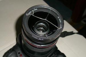

What a coincidence! ... just yesterday, my 5D MKIII with EF 16-35 f/2.8 L II mounted on Manfrotto 055CXPRO4 got flung out about 10 feet from a height of 6 feet ... when I saw it fall, I was pretty certain everything must've died ... but to my great relief, the 5D MK III had two tiny scratches, one bottom leg of my Manfrotto broke (http://www.canonrumors.com/forum/index.php?topic=18004.msg333840#msg333840), and the EF 16-35 L II lens had a dent on the filer thread. But what protected the front element of the lens was the 82mm B+W XS-Pro filter, which cracked after hitting a metal hook on the shipyard floor. I borrowed a Plier from one of the electricians at the shipyard and gently broke the glass of the B+W filter (as I could not remove it from the lens due to it being stuck real bad) and continued on with my shooting.
While I understand and agree with Richard's point of view about cheaper filters, I think it is important to have the best filters you can afford on your better lenses ... had I not to have a filter on (or even with a cheap filter) I am pretty certain I would have damaged a lens, that would have cost me almost $2000 to replace, instead I'm only looking at $150 to $175 to replace the filter ... but most importantly I would not have been able to complete the shooting.
My view on having filters on all the time (on all my lenses) is that it is one less thing for me to worry about when I take the lens out ... if I keep removing filters and putting them on (for normal / not so safe places), I most likely will forget to put the filter on one day and that could be the day, like yesterday, when the lens fells down ... its like my insurance, better to have it and not need it than to not have and need it.

Top one doesn't have the filter. At least, that's my deduction. I use filters when walking around just shooting random images/ scouting locations. When doing actual work, I prefer to not, if conditions allow
Canon 7D, 1/320s, f8, ISO 200, on board flash. EF 70-300L IS USM.
Good luck!
D
The top one looks to have a little more contrast, unless lighting changed slightly.

How about another pair of pictures, this time with a light source (desk lamp, ceiling lamp, etc.) in the frame...

Yes, Sir-----I think my Filter might save ( ??) my Lens, When I drop the Camera with Lens hit the hard ground first.

I've spent more money repairing (pretty damn sure) my 2 most dropped lenses.   70-200/2.8I and 16-35/2.8II.  In both cases I DO NOT use filters on them.   The only filter that will ever see use on either is my 8 stop ND.  Beyond that I've never had a drop where it's had an problem damaging the front element and trust me, I've had some damn good drops.   Filter ring, especially on the 16-35 always seems to take the brunt of the damage.  Where as having the lens hood on the 70-200 is it's saving grace.

It looks like an 82mm B+W XS-PRO filter runs just shy of $120.  With the original filter in pieces, a replacement would be needed, so I'm wondering...
How would the cost of replacing a front element compare to buying two of these 82mm filters?  (Anyone know what a front element would cost?)  Is it a wash?
Considering it a bit further...if the lens needs service for bent filter threads and/or misaligned groups (to put it back in perfect working order), what would that cost, and how would (case A) the cost of two filters plus service compare to (case B) service that included the replacement of the front element?
To date, I am happy to say I have no experience with such things.  (Dropped filters, hoods, and caps are another story altogether....)
Each model lens has a different cost. But I imagine that replacing the front element (depends on Lens) should cost more than 40% of the lens, which can mean almost $ 1000 in a 24-70 F2.8 II. The big question is: Use the filter would prevent further internal damage, or the front thread of the lens? And if repairing internal damage and the front thread costing 30% of the lens, the 10% difference is worth the use of expensive filter? I still think that using the lens hood protects better than a filter.
