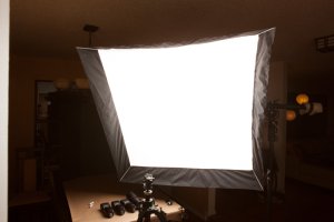

It depends on how realistic you are with regards iso and aperture.
Here is one 600-EX-RT in a 50" Westcott Apollo at full power, the room shot is f2.8 and iso 200, 1/160 and clearly overexposed at around 7 feet to the wall, the shot of the box illumination, which is remarkably even (the flash was zoomed to 20mm) is f10 at iso 200 and 1/160.
The 50" Apollo is a true 50" x 50" and can easily cover several full length subjects, it has a front screen but the beauty of its evenness is that it fires the flash into the box, not out of the box. I normally use it with three flashes on a triple clamp.

Thanks private, very interesting those Appolos, I'll need to inquire. Your pictures also give a good idea of the 'max' performances one can expect from a single speedlite in a softbox. I could probably live with iso 200, maybe even 400 as the images are going to be for my own personal enjoyment and I mostly want to learn the trade of off-camera flash.
