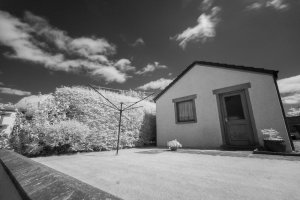

oops, just spotted this thread - I just posted a new thread re IR use - this lens is very good! R72 filter and no hot spots... very clean & sharp across the frame, I used the IR focus mark on the 'window' and got very good results in strong sunlight.
Sorry about the subject matter, only a test shot!

« Reply #12 on: June 24, 2014, 11:52:02 AM »
Another shot this afternoon...
Lovely shot!
