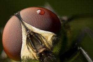

As you can see the difference between 1:2 and 1:1 is quite significant. Personally I love and use Sigmas 150mm 2.8 macro lens. Image quality is stunning and the extra reach certainly gives you an edge when shooting insects and the such. It comes with image stabilization, AF and does not extend when being focused.
As for AF, it really depends. It's great for moving targets, but be prepared for a lot of hit and miss regardless. For pure static targets manual focus is king if you have enough time and a sturdy tripod. Where AF is also very helpful is when working with image stacking. Attach your camera to a remote computer and you can adjust the focus plane without having to touch the camera. This will make the stacking process later on a lot easier to do.
P.S. In the above picture the 2:1 shot was achieved using the 2x Sigma converter. You loose AF (at least on my 7D) and overall image quality does suffer somewhat. It's better than resizing the 1:1 photo, but not by too much.
