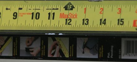

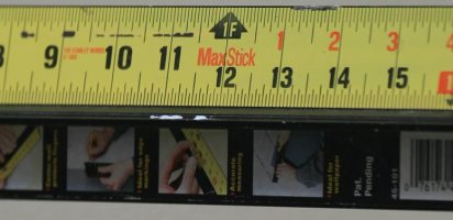

Did some tests as a result of a discussion on another thread. Comparing the sharpness of the 2 great lenses with the following test conditions: Subject shot = a Ruler placed 45 degrees on the wall and focused on the 12" mark.
Attached are 3 shots; 2 of the 70-200mk.ii (I have 2 copies, the old one is a refurb unit and the new one is a new unit bought from adorama) and the last 1 of the 70-300L
1) ISO = 100
2) F5.6 (favors the 70-200 slightly since it is natively larger aperture)
3) 5D mounted on tripod
4) camera jpeg used: zero PP done except 100% crop .
5) Spot AF at the 12" Mark. Did not MF since I seldom use MF with these 2 lenses; Spot AF relevant for my use.
6) Used various focal lengths but the attachments are for all 3 at 200mm
7) Ruler was vertically placed with top = higher numbers on scale. After cropped I turned the crops 90 degrees clockwise for better viewing.
Conclusion:
1) The 2 copies of the 70-200mk.II are very similar in sharpness and focal length
2) The 70-300L set at 200mm shows a smaller frame compared to the 70-200's not sure which one is accurate the 200's or the 300.
3) The 300 seems slightly sharper than both (though it is a toss) and has a greater DoF at f5.6 than the 200's.
Hope this helps people who are considering both:

Thanks for the tests!  I will reiterate that using autofocus is not the best way to test lens sharpness, since you're not testing just the lens, but how well the lens is matched to the camera's AF.  Also, an angled ruler is a challenging target for the AF system. So, while I appreciate the efforts, and acknowledge this test has meaning for your camera+lenses, I don't believe the results can be generalized to these lenses as a group, due to the confound of using AF (with no ability to calibrate it).
I understand about generalizing the tests for all lenses.
However, grant me this... if I saw the numbers sharper at the higher or lower end of the scale (lets say 13" or 11" etc, then it would indicated forward or back focus, this is not the case, the lens is correctly focusing at 12"
The older 70-200 (1st pic) has a slight back focus, however it is still withing the dof and captures 12" at good sharpness.  The second is centered at 12" meaning it is optimally focussed.
Given that the slanted ruler, an inaccurate focus would be visible either up or below (instead of 12"), thus I still believe, this test is valid for this set of 3 lenses.
The proof is that maximal sharpness is visible between 11.5" to 12" for all lenses.
« Last Edit: December 03, 2011, 09:17:32 PM by K-amps »
