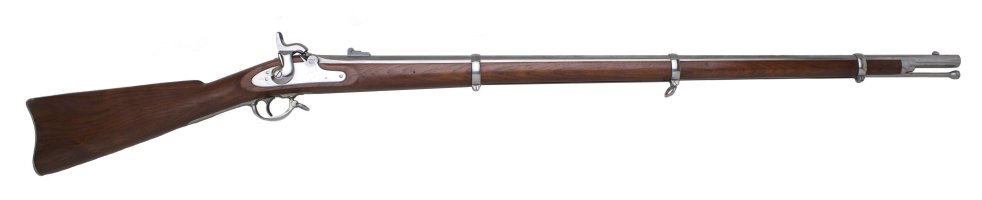

... that is unusual in shape (antique US martial firearms: about five feet in length). Photos are taken from about three feet away. I currently have a T3i with the 18-55mm lens it came with. I am considering the Canon EF 16-35mm f/2.8 L II USM Zoom Lens. However, would I be better off with a prime lens and, if so, which one? I am willing to pay a premium for the L-series lens.

I think your photo looks fine.  The "1864" is visible.  Looks quite sharp (but being compressed, it's difficult to tell).  Just wondering where you feel it falls down?  Most Canon kit lenses should work fine for product shots.  You're generally shooting stopped down a bit (maybe f/8 or f/11), using a tripod and have full control over the light.  (BTW, if you're using a tripod, try turning IS off and see if that improves anything).  I doubt that a more expensive lens would give you noticeably better results.  If sharpness is the issue, I'd try moving back a bit and using a longer lens (at least be at the 55mm end).  For an object so long, if you're shooting at only 3 feet away, it would be difficult to get the whole thing in perfect focus.  Whereas, if you were three metres or further away, it's a lot easier.

What came to my mind... If you're short with the space, you maybe could simply put a good quality... mirror in place where you shoot from and put a camera above the gun. This way you'll be twice away from the subject so it can help you find your sweet spot with current gear (sharpness all over the subject and less distortion to remove in postproduction). Good mirror may be cheaper than good lens. :)
BTW you achieved very interesting result with your lighting focused just in the center of the gun and not at both ends. This light has to be really strong what is visible in reflections on metal elements on the right. More ambient light would probably allow better control it but could not give such an interesting result.
