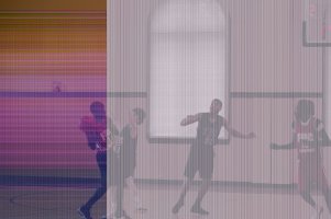

Has anyone ran into this hiccup with their 1D Mark IV?  I was shooting a basketball game today, and this happened to only one out of 890 photos (~photo 390).  It's also never happened in the history of my camera or card.
I'm wondering if it was a hiccup in the camera itself, or perhaps the CF card (Transcend 400x 64 GB).  I have no way of knowing unless it happens again with a different CF card, or unless someone else has experience.  Obviously my concern is forthcoming equipment failure, but if it was a random "solar flare" initiated event, I won't worry.

My 7D did something somewhat similar...  But it looked more like some one sprinkled rock salt on the pict, big and specific noise allover the pict.  I found that the batteries had been run down to the very end. I had left them in my camera for awhile so they were weak to begin with, and then I finished them off with a bunch of quick shutter speed bursts.
So could it have been batteries? Just a thought :)

Low battery is a very good thought.  I was shooting with a full charge, and I just verified that it's still full.

If you get a few corrupted memory locations on a card, one image might be affected.  It won't happen again until your camera writes to the same memory location.
Do a erase and then total reformat on your computer.  Reformatting in the camera does not detect the bad memory block, but a complete erase writing all zeros to every location on the card will detect bad blocks and mark them as bad so they are mapped out.
I use Image Rescue 4 to erase a card.  It takes a while, since you are writing to every memory location, and verifying it.  Then do a complete format.
Of course, if your memory card is dying, then more bad memory blocks will develop in the future, and you will need to replace it.

Well I'm pretty sure it was a bad spot on the card.
