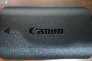

Yesterday I received a couple of LP-E6N Batteries and noticed something wasn't right. They charged ok, the camera gives battery info and everything seems fine. But externally... I'm leaving a couple of pictures, one of the is the original that came with my camera and the other is one that I received.
What do you think? I'm not telling yet which one is since I don't want to bias the answers in any way.

This side of the battery seems always the same. The label side could show some perceptible difference between an original and a counterfeit.

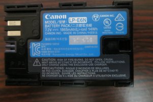

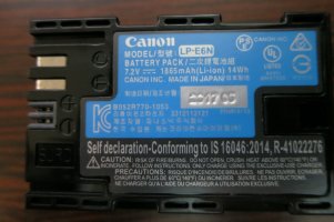

Ok let's see, here you have pictures of both labels.

B is a fake.

The battery "B" presents imperfections in the clipping of the label.
The embossed inscription looks coarse, and the surface of the plastic has curvatures, where they would be straight lines.
"Made in Japan" seems strange to me, since Canon camera batteries have been made in China for more than a decade.

B is a fake.
+1
They couldn't even manage to get the arrowhead straight.

My bet would be on B being the fake, the moulded in Canon lettering has flaws, a lump on the C, the tail where it joins the 'a' looks parallel where the genuine is tapered to a delicate point, the n appears to have a lump and the overall definition in the lettering seems poor, battery B seems to perhaps be uneven on the top surface, but that could equally be shadow, the label appears to have a jagged edge along the bottom, plus the date on battery A is 2015 and battery B is 2017 ;D plus made in Japan?  ???

The Canon logo was the most screamingly obvious fake I had ever seen as it was so crude.

Sorry I forgot to tell, yes the "B" is the counterfeit, thank you all for your input!
