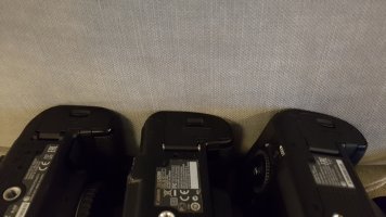

Mine is also prone to open. This is a design miss: the rubber flap extends past the battery door. On previous cameras, the battery door protected the end of the flap in such a way that you could only open the flap with the battery door open. Attached picture shows flap, from left to right, on the 70D, 5DmkII, 5DmkIV.
Yes, I've noticed the same problem on both the 5D4 and the 7D2. I can't see any logical reason for the change.
The 80D, which was launched before the 5D4 but after the 7D2, has the 'old' but better design.
