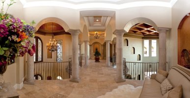

The best description I've found is at http://reallyrightstuff.com/WebsiteInfo.aspx?fc=108 from the people that make the equipment to get it right. When done properly, even interior panoramas are outstanding!

By the way, the picture above is 4 Portrait Orientation shots from a 5DMkII and 17-40 lens.
That shot looks pretty darn good.
How much work was done in processing?
Do you use the RSS products?

Yes Danski, I do use RRS but not the panorama line of accessories. Want to, but can't justify it yet. I first got the flash bracket kit for shooting weddings. Of course I use their L brackets on my camera's so they clip into the ballhead, I use a BH-40 on a Slik CF tripod that I got for $60 on ebay...one bottom leg tightening mechanism had the epoxy broken, so I sanded it down and reapplied epoxy to get a nice Carbon Fiber tripod for $60. Used left over epoxy from a sledgehammer handle if you can believe it! lol
Anyway, I use the rail that the flash bracket mounts on to get the nodal point. I don't take a bunch of pictures, just look at live view while rotating or swiveling the camera on the mount to check for parallax....line up two vertical objects, one relatively near the other at some distance (a fence post and a telephone pole for example) slide the camera back until the two stay in relation to each other and there it is. You can then mark the rail as to the lens and focal length to make it easy to go right back to that point next time.
I use Photoshop CS5 to stitch the pictures together in an automated fashion, no work on my part. I hear CS4 is as good or maybe better in that regard.
