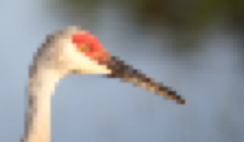

adamr
  • Guest
Re: 5D Mark III File Issues
« Reply #14 on: June 30, 2012, 05:55:12 PM »
I got my 5D3 last Friday and took few hundred photos with no issues.  Today I took ~200 photos and 3 of them in a row were corrupted.  Lightroom 4.1 could read 2 of the 3 but chunks of the photos were missing.  It wouldn't read the 3rd.
DPP could read them but they were blocky/pixellated (like they had been reduced to a small size and then blown up).  It could not export them to jpg.
This was with firmware v1.1.3
Attached is an example of the jpg output from Lightroom 4.1 and a crop of what Canon DPP shows me for the same file.
