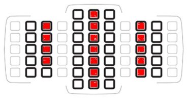

Yes i have found while it will actually achieve lock in lower light than the mk2 it struggles and takes too long in really low light
so far the best solution i have found is using my yongnuo ST-E2 copy for AF assist
withsome slight movement of the head you can align the beams to the AF points, i have tested
and found the following AF points benefit from this
the main problem is that it wont fire the flash :(
 well the flash will fire but its out of sync
