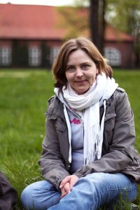

I did a very quick edit (about 30 secs) of your first image. I started off by increasing the exposure by around 2/3 stop (I could probably have gone a bit further), then I did a curves adjustment, followed by a levels adjustment to fix the shadows I created from the previous step. With a bit more care, I could probably have achieved the same in less steps. As was mentioned, it's all about nailing the exposure and in some cases, getting the lighting right. The in common with all photos, it will need some processing to get the best out of it, particularly when shooting RAW, as they usually need a contrast boost (except in hasrh lighting). It could probably do with a slight hue adjustment too.
I just made some adjsutments to colour balance and dodged some of the shadows.

I imported your image into lightroom and just hit the auto tone button.  Then I backed off the exposure slightly, and added to the saturation slightly.  You can make a image look any way you like it, I preferred to lift the shadows so you can see the eyes. A little work with a raw image, and the eyes would brighten up even more.

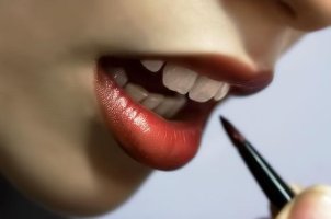

My swing at it.  levels, curves, contrast, adjusted color, fixed tones and skin, a bit of dodging and burning.  All and all about 2-3 min of work.

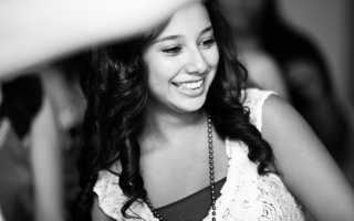

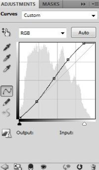

Quick edit.  Using only curves and vibrance adjustment layers.  Basically you're exposures aren't perfect so the curves adjustment gets better tones for the underlying values, and then the vibrance adjustment makes the colors pop.  Do the curves first.
Attached is a picture of the curve used, Vibrance was set to 63.  I'd also try to get better exposures in camera, you can practice this by shooting in B&W and if you shoot in RAW, you can always shoot in B&W on camera and it will still keep the color data of the shot when you get the CR2 file back onto a computer.

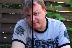

Here is a before and after-RAW-processing shot. You can see how I've altered the result to fill more of the eye's desire to see light and color. It feels that I've used a flash on the subject's face. This was a good case to get such a result because the original shot had enough light and tonal range in it to withstand the drastic changes that I've done to it. (You don't normally get such good results with room lighting.)
The colors are wacked in Chrome, so don't mind that.

NotABunny.  My eyes feel you are going too strong on raising the black point (not that you didn't set the black point where it needs to be, you did, but...) I am seeing a loss of detail in areas like the hair of the man behind the woman and the other man on the right's face, and so on (basically anything in shadow is getting some detail clipped).  Nice picture, improved by your editing as well, but I'd try to get that detail back either through masking or via altering your settings/procedures (using 'fill light" in RAW maybe in combination with masking, etc.).  It's a nice picture and I think your adjustments improved it further, but I would like to see those details return, it will add additional contrast to the overall image.
