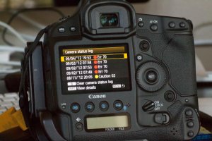

Hi all
I've read about the err80 problems which luckily I haven't encountered yet, maybe because I haven't used it with 85L.
But
0.5 sec exposure +/- 3 EV Bracketing (ISO 160 at F/13) causes the shutter to stay open and the camera displays err70 as you can see in the photo attached. This happens with or without a memory card installed.
This is happened on the last (In my case the longest exposure) It works fine if the base exposure I start with is at or faster than 0.5 seconds. The longest successful exposure I got with bracketing was 4.5 seconds.
I am using a 70-200 f/2.8 IS , it first happened with a 2x tc on. Same deal with a 135 f/2.
Interestingly enough, if I change to f/2.8, It works fine at the same shutter speed with braketing, :/
If anyone has any idea or can reproduce this error I would really appreciate any info. I will be contacting Canon tomorrow and see if they have any information.
Sometimes it doesn't display that error and just stays there as if it is shooting the photo but doesn't nothing for minutes straight at what point I restart the camera.
Thanks!
*UPDATE*
There is a firmware issue causing this.  Something to do with the timer and long exposures. The next firmware update (no ETA) should fix it.  No hardware needs to be touched to fix it. No need to send your camera in if you are seeing this particular issue
I had exactly the same thing happen to me this morning.  70-200 II at 5.6, +/-3 bracketing and got the error 70 several times.  Single shots at the same exposures work fine....
And I can't call Canon 'till Tuesday.
/sigh
/sigh
Sorry man :/ I am in LA to drop off my camera at Canon. I'll prolly hear from them next week, I'll update this thread if I find anything from them. Btw for me I found this only happens when using AI servo, doesn't matter if you focus or not. One shot seems to work.
-Devank

« Reply #11 on: September 04, 2012, 11:38:04 AM »
Hmm.  I never did play with the focus modes.  I had it set on Servo, IIRC, but wasn't really concerned with that.
As it turns out, CPS had a rep on call on Saturday late so I did get to go over the issue in depth with Canon.  I'll be shipping it to Irvine today or tomorrow for them to evaluate.
I'm 99% sure it's a firmware bug.

« Reply #12 on: September 04, 2012, 06:03:31 PM »
Definitely looks like a firmware bug, that is why I was waiting for their first firmware before I send it in, but after installing the new one it didn't change :P, I'm guessing its some unique combination of settings that is messing it up. Like you and I both have tried, it works in single exposures ^_^

Feels lonely without the camera though, I sure hope they get back to me asap   :-\
Yeah.  Mine gets to Irvine tomorrow and, hopefully, back to me by very early next week.  I've got the 5D2 and 20D in case I need them, but it was going to be a quiet weekend anyway.

Definitely looks like a firmware bug, that is why I was waiting for their first firmware before I send it in [...]
Any word on yours yet?
I spoke with the repair folks yesterday and, for some unknown reason, they are replacing the main board on mine.  I'm definitely not pleased, especially if it doesn't actually fix anything.
Just curious if yours was really a firmware issue or not.
