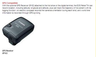

Well ... The 1DX uses the GP-E1. In addition to the 5Diii and 7d firm2 [limited functionality], the GP-E2 will also work with the new T4i [see attached 'snap' from Canon's website] and upcoming M [mirrorless] http://www.imaging-resource.com/PRODS/canon-eos-m/canon-eos-mA.HTM with complete functionality, like compass direction. I'll assume this will be Canon's new standard GPS for most upcoming models. So does this mean some 3rd party will make a cheaper version someday? - probably so. How about a wireless version?
Well...the 1D X can use either the GP-E1 or the GP-E2.  But GP-E1 can only be used with the 1D X.  The GP-E1 does not offer the logging function that the GP-E2 does, but it's smaller and more robustly constructed (better sealing), allows simultaneous use of a hotshoe-mounted flash (without needing to resort to the USB connection), and it's powered by the camera battery rather than an internal AA battery.
