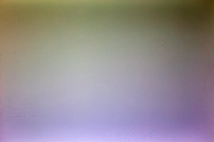

Hi! I have posted before that my 1D X came from factory really dirty and I didn't really wanted to send it to CPS since my experience with their cleanings is disastrous.
So I tested first the camera cleaning, NOTHING....  absolutely no difference at all.... nada... wondered what is that Canon bragged so much about it...

here is before cleaning.....

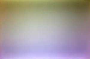

so then I tested the Dust Aid Platinum wand....  very cheap... but still some dust that was adhered to the sensor and seems that the silicone on the wand was not strong enough to get it off....  but a huge change for a dry system. A blower didn't move, clean or remove this dust....

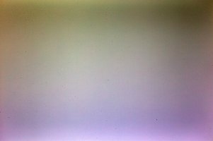

so then I tried the Sensor Swab with Eclipse.... which sort of removed it... but I always have an issue with the Eclipse and Sensor Swabs...  always leave behind traces of the fluid and the Sensor Swab always leaves dust behind, seems to be a magnet for dust.

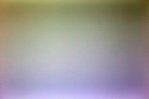

then I used Dust Aid Swab with their dust free cloth... and their fluid. Which to my surprise leave no trace at all.. so pretty happy with results of this very cheap solution.
