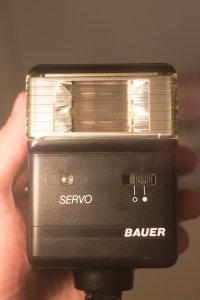

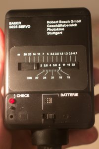

Hi,
somewhere along the lines of my interest into yongnuo flashes i somewhat happened to get an old Bauer flash for free! Its the model 5028 servo. Im just not sure if i can use it with my eos system or if its gonna fry it up cuz of electrical differences. Any experiences?

Here's a link to a flashgun voltage table. Although not quite the same model number as yours, the Bauer unit listed has an incompatible trigger voltage. If I were you, I wouldn't risk it.
http://www.botzilla.com/photo/strobeVolts.html

Early DSLR's were susceptable to high voltage at the triggering of a flash.  Canon redesigned the flash circuits so 250 volts is not a concern, but I'd stay away from flashes that produce 400v or higher.
here is a popular list  http://dpanswers.com/roztr/volt_finder.php
Old flash units can be had for $5, so just pick a low voltage one, imho.
