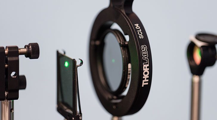

If you’re thinking about buying a circular polarizing filter, you probably want to know which ones polarize the best and which ones the worst, right? I know I did. Now we could have just gone outside and taken pictures in the bright sun and said this one’s good and that one’s bad. But we never do anything simple when we can complicate the crap out of it.
So what we did was take our laser transmission set up and modified it a bit. Primarily, this shines a laser into a power meter and gets a reading. Then we can stick mostly transparent stuff in the beam and see how much it reduces the power reaching the meter. Excellent lasers are almost entirely polarized, but I have a budget, and that budget didn’t include (much to my sorrow) $10,000 for the lab-grade, steel-melting laser I wanted. I got a little 5-mwatt green (530 nm) diode laser.
